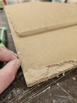

The base fiber board was very poor quality and soft, but it didn't matter as it was hidden and non-structural. Cut into shape 132×82 with a carpet knife, to match my 130×80 IKEA table.

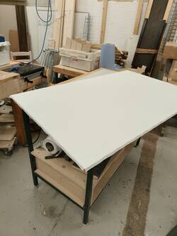

Soft mat was glued and stapled on to provide a softer feeling. Later, the spray contact glue separated. Perhaps I used the wrong type of glue on this.

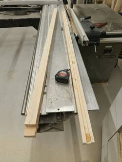

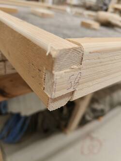

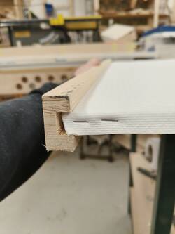

The rim was made from a single board, first cut into smaller strips. Then a U-shaped groove was routed into the middle to catch the edge of the base board. Edges were rounded on the router and joins were cut with a band saw. I then realized that the rounding should've been done after gluing together. Now there is rounding in the corner itself, which I tried to fill in with wood filler but the results were poor.
Because of the rim design, the fabrics had to be prepared before gluing, sanding and finishing. This was a big design mistake.

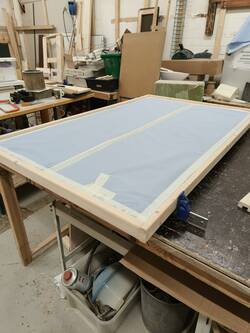

Next the speedcloth was stretched and stapled around the backside of the board. I should've paid more attention here. Once the table was ready, the fabric was still a little bit loose and not fully tight as you would wish. I covered the fabrics with paper and tape to protect them from sanding dust and wood dye + lacquer.
Then the rim was assembled around the base board and glued in place. The corners were given final sanding and wood dye was used to make it a little prettier. I also applied one coat of lacquer, but the long drying time meant I did not have time to do multiple coats like you are supposed to. In the end the wood remained rather raw, but worked well enough. Surprisingly none of the glue or dye leaked onto the fabric.
