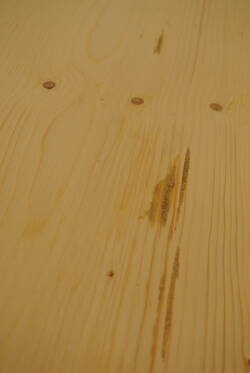

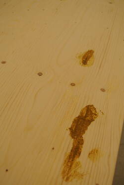

  • It's better to buy a qood quality vaneri if you want to have a nice surface. Fixing defects takes a lot of time and extra money (I def. didn't fix every defect in mine)
  • When Filling in holes and indentations add excess material, and remove it once it dries
  • The wood dust - glue mix has weird yellow-green color after drying. It looks a bit better in thicker layers. But it's free!

table_1.jpg fillers_1.jpg fillers_2.jpg fillers_3.jpg frame_1.jpg frame_2.jpg frame_3.jpg ready.jpg
